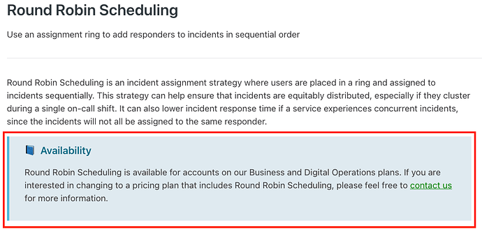

I’m in contact with the support, and there is a bug when using “escalation_rule_assignment_strategy” parameter.
If I remove it, TF and API call are OK.
No more information about the fix of the bug !
Hmmm… Ok, I get it now. What your experiencing is a feature gating issue, because as You mentioned at the very beginning, You currently using free version (Sorry, I overlooked that detail). Read more about this here. In same way, I’m attaching a capture of the heads-up at Round Robin Scheduling product page.
